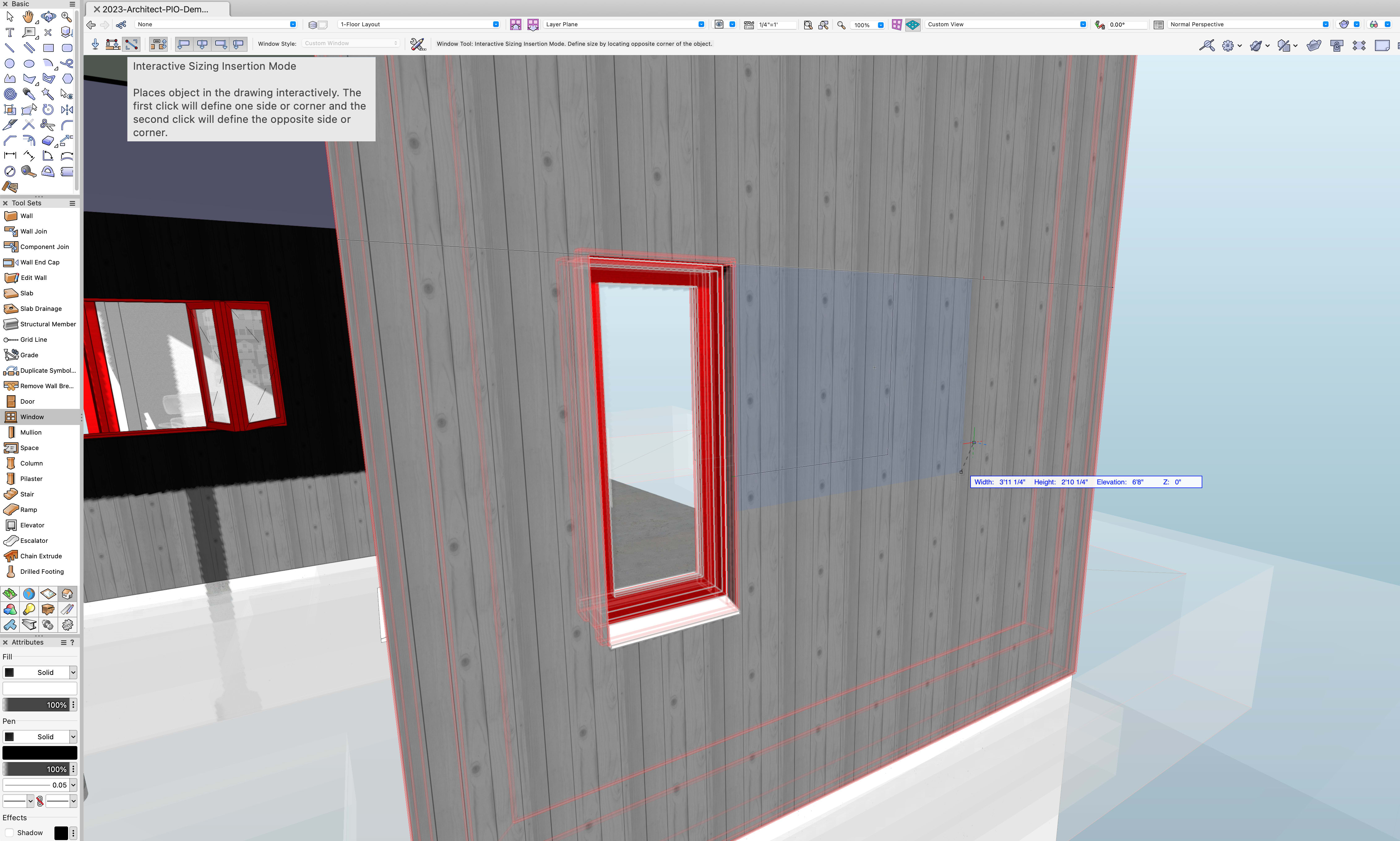

With the Interactive Insertion Mode selected, you can place a door or window in 2D plan view by clicking in two locations to dynamically set the object’s width. This allows you to freely insert windows and doors in walls and size them relative to other objects in the design.
In 3D, you can use interactive insertion mode to draw doors and windows directly onto a wall or other surface, dynamically setting width and height. With no restrictions, you can easily experiment with size and placement to explore design options.
To achieve precision, you can enter exact values in the floating data bar that appears as you’re drawing. There are also smart points associated with the door and window objects that you can use to easily align objects by elevation.
You can also edit existing doors and windows by selecting the desired object and simply resizing one of its resize handles, as shown below.
