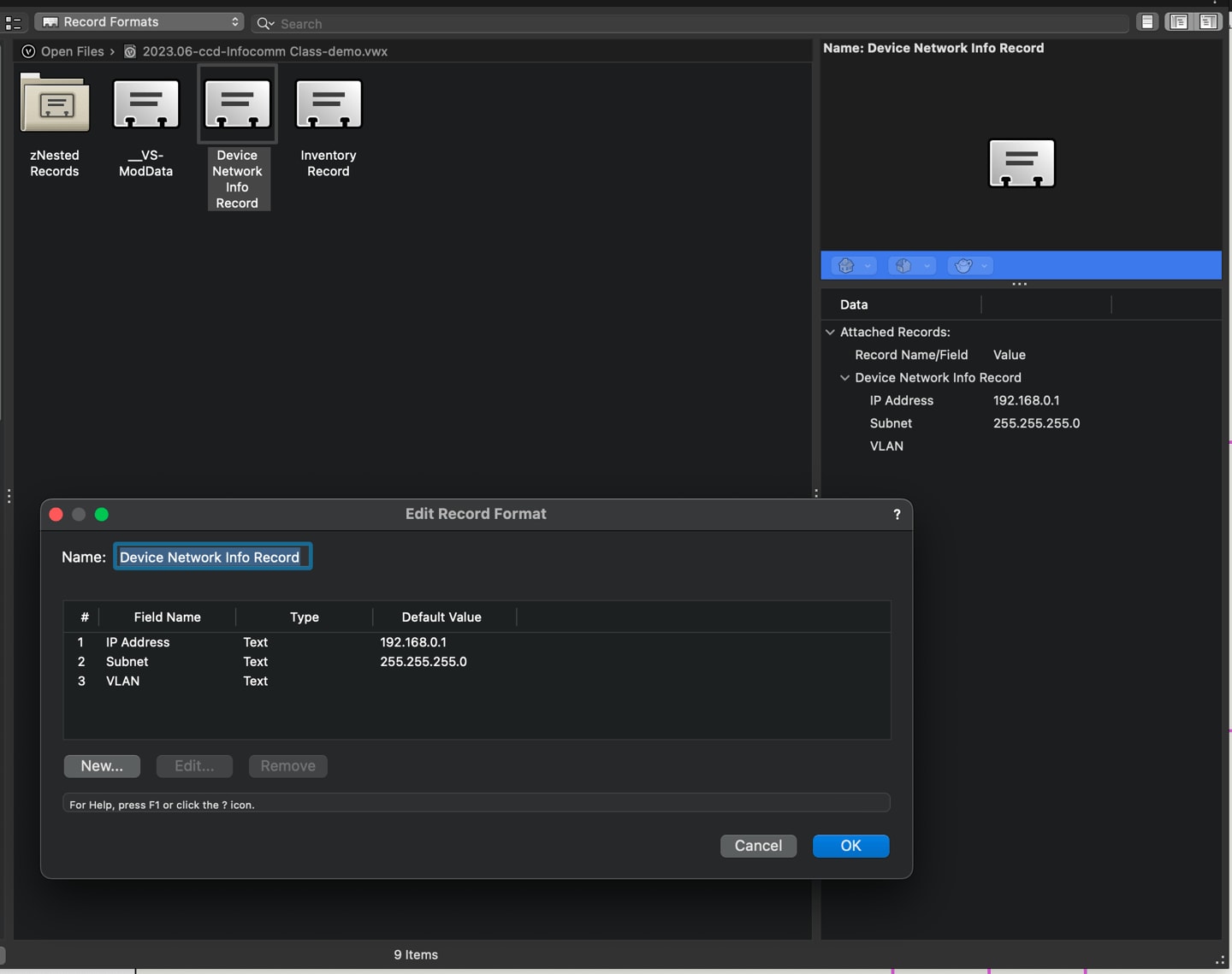

Creating a Record Format for, say, all of your AV equipment can help your crew know the serial numbers of every device, where it should be located, and even cost — saving them from the tedious processes of trying to sort all of this out at each venue once the materials have left the shop.
To create a new Record Format, start in your Resource Manager, and then select New Resource. From there, select Record Format from the tool bar, and click New Record Format.
The Create Record Format dialog should then open for you.
Next, enter the name of your custom record. Name this whatever you like, but we recommend following some sort of naming convention.
After you name the record, all you need to do is select New to define any parameters (such as type or database connection information) you may want for your record.
